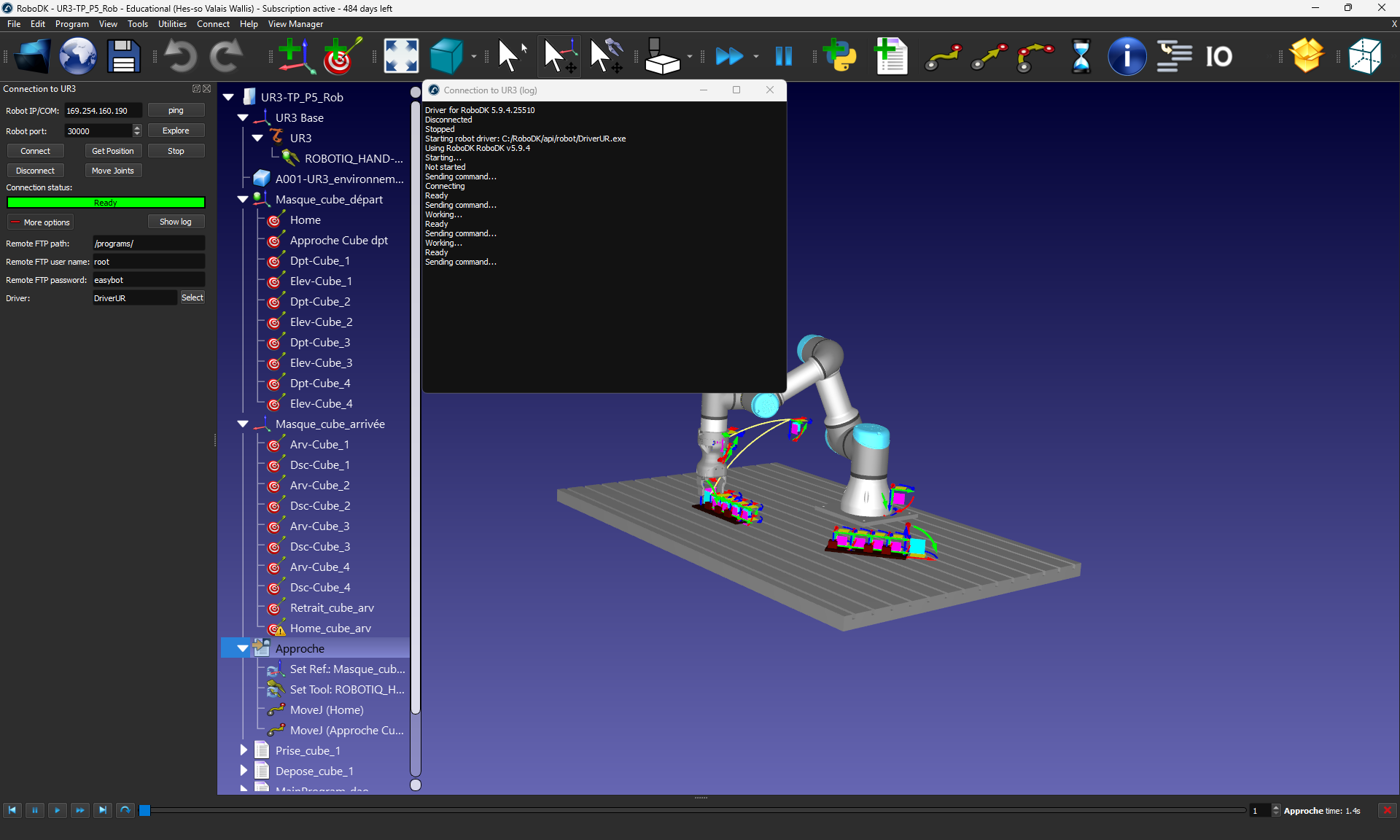

Hello, brand new user of RoboDK (v. 5.9.4) here. Attempting to do on-/offline programming of UR-3 robot with the software.
Here is my configuration: UR-3, CB3.1, Polyscope 3.15.8-build10.6.339, URCaps: only Robotiq_Grippers, version UCG-1.8.9.14887
I can connect to the robot, but only with the driver “DriverUR” (the legacy apiur driver will not connect). I can select a target position and ask Move Joints to have the real robot moving to the requested position. I have read the help instructions Run a Program on the UR controller.
When I attempt to do Online Programming (Run on robot), nothing happens. No error message in RoboDK, just the status message “Sending command” (see attached picture), no error message on the UR-3 log.

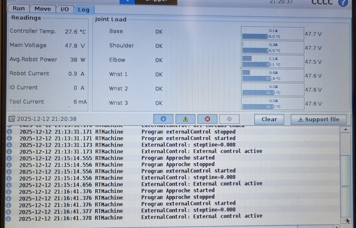

When I attempt to do Offline Programming (Send program to robot), nothing happens either. The transfer is successful, I do see new entries in the UR-3 log (see attached picture), but the robot doesn’t move.

Can you try generating a script file and/or a URP file and load it on your robot controller? You may need to use a USB drive to transfer the URP file, or create a new program to load the script file. Youc an find more information here:
https://robodk.com/doc/en/Robots-Univers...tml#UR-URP
If you use the Univeral Robots URP post processor it will generate a program that can be loaded in the controller and you should properly see the instructions in the tree on the teach pendant of the robot.
Does the gripper work properly? It is strange to not see any error messages in the log window and for nothing to happen as if the connection was successful.
Hi Albert, thanks for reaching out to me.
Yes indeed, the generation of script and URP file is working properly and I can transfer them to the robot controller via FileZila (which I lunch from the Connect Robot > Explore button in RoboDK).
I can not operate at all the gripper from RoboDK. This will be my next hurdle. The gripper is working fine with the RobotiQ URCap in the robot controller. I’ll start a new thread in this forum about resolving the operation of the gripper once we figure out what is going wrong with the Off-/online Programming, since I am suspecting it might also affect the gripper control.
You probably have a version of the RobotiQ URCap not compatible with the RoboDK post processor or driver. You may need to generate a program from the Universal Robot controller user interface and take a script file from the controller (the script files are generated automatically).
You should then follow the steps outlined in this section of the documentation but update the script code in the header program (long code related to managing the RobotiQ gripper):
