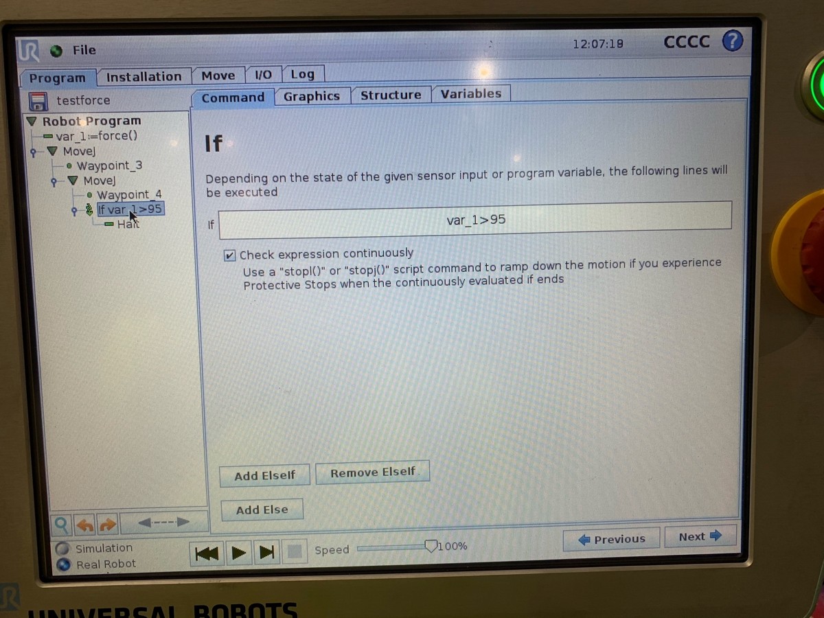

UR10 force() mode
On the UR10 I can use the force function force() to halt the robot when it finds the part. What's the easiest way to replicate this on RoboDK? My guess is that I need a python script with the position of the part and a loop checking the force() variable. Is there an easier way?

Hi Jeremy,
Thanks for the reply. I'm programming a UR10 and RoboDK has been excellent so far but I'd like to use the force mode of the UR10 and I'd like to run the program exclusively from RoboDK (that's what I've been doing up until now - i.e. I'm not transferring programs then running from the teach pendant).
The force mode seems relatively easy to use on the UR10 so I'd like to take advantage of it in RoboDK. I want to send the robot to a target but also monitor the force() function as it does so.

Hello, I ´m in a similar problem.
I need to program from roboDK that my UR-5 stops at the moment it detects a greater force (for example 1 N).
How could I do it?

The easiest solution would be for you to look at the script programming manual of UR, figure out the command you need and add it as an "Insert code" in a program cal in your RDK program.
"Insert code" will simply add the text you give it in your final program.
