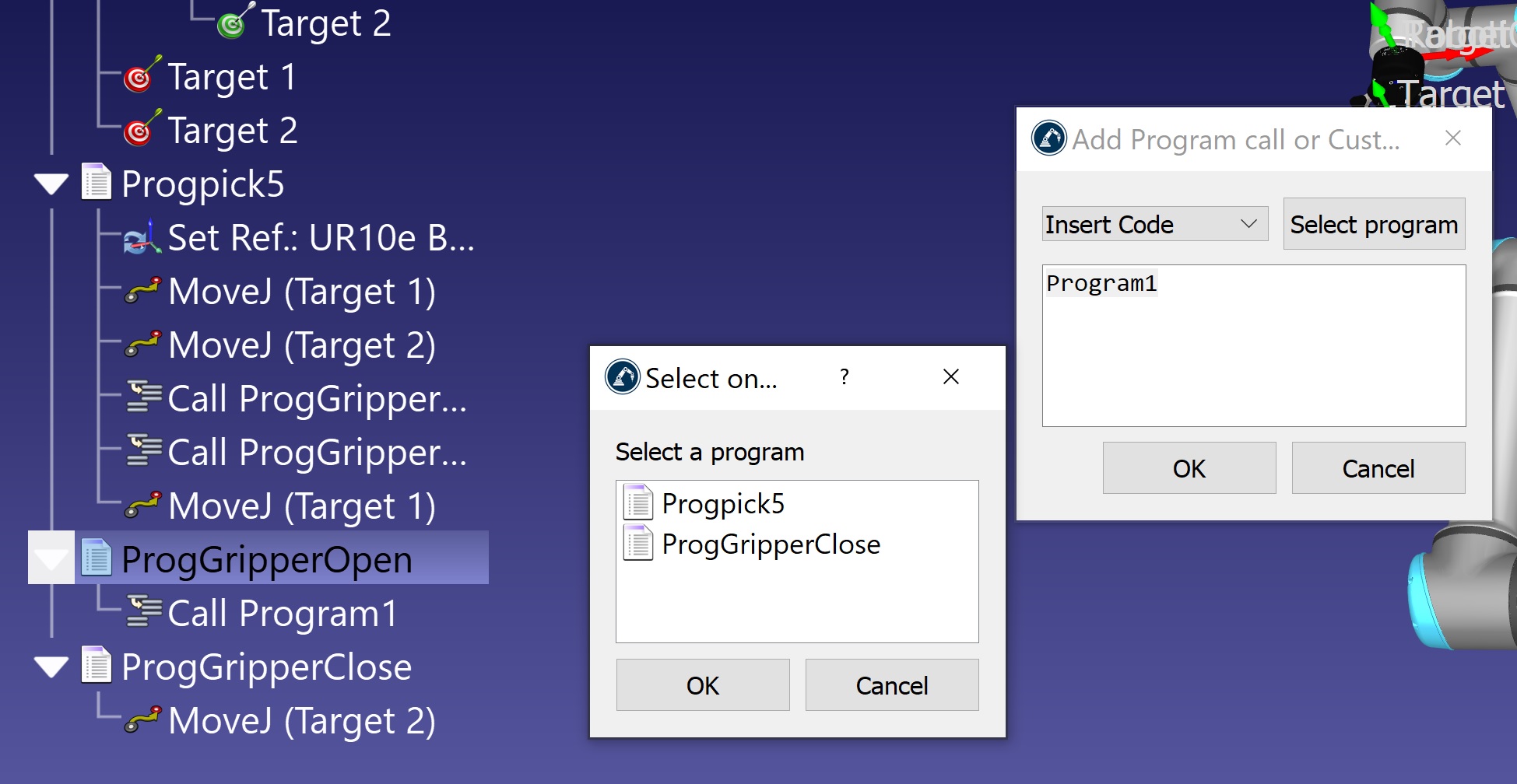

Hi Jeremy,
Thank you very much.
I am trying this on-site but just feel a little confused about Step 4. I expected to see the script file name of 'ProgGripperOpen' (which I had created separately) showing in the 'select a programme' but it didn't (see photo attached). So I tried two options:
1. type in the 'ProgGripperOpen' file name in the text box,
2. copy and paste the full context of the code of 'ProgGripperOpen' into the text box.
Sorry but neither of method worked. It would be much appreciated if you could clarify Step 4 a little bit more. Thank you for your patience.
Kind regards
Ruoyu
When you have "insert code" selected, you shouldn't press "Select program"
You should enter manually the line of code you want to see in the final program when you "right-click"->"Generate program"
You need to find the line from the "script" language.
