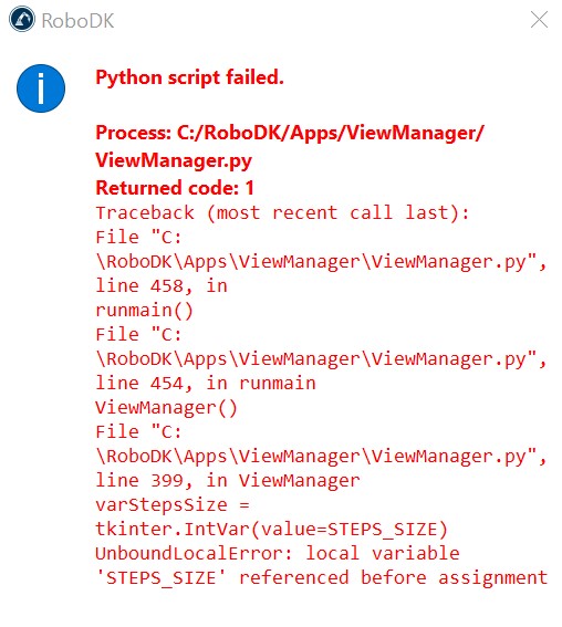

But clicking on it I got the error shown in the attached image (jpeg, screen clipping).
View Manager not working as expected - "Python script failed" |

04-14-2023, 03:14 PM
Can you try with the latest version, available here?
https://robodk.com/addin/com.robodk.app.viewmanager

04-17-2023, 08:38 AM
Thanks Sam, that seems to have fixed it in that the error message did NOT appear and the View Manager menu did.

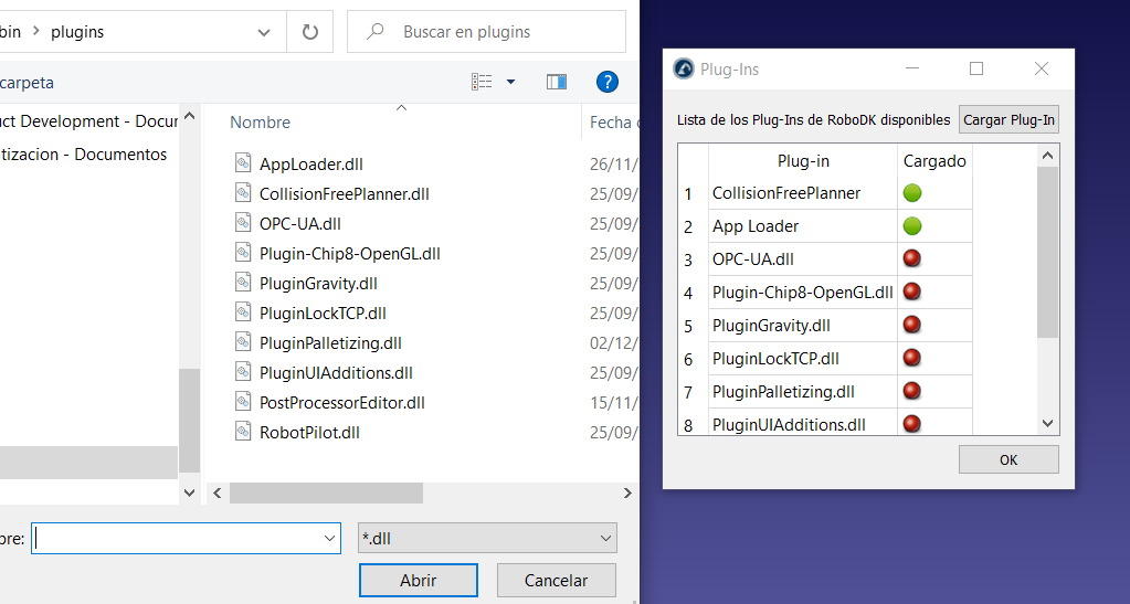

I have downloaded and installed Shape Add-In from the ROBODK online library and when I opened it from ROBODK I get a warning saying that the phyton script has failed.
I would like to know how to solve it. Thank you
08-24-2023, 11:52 AM
You can install the Python requirements needed for an add-in by right-clicking it in the Add-in Manager, and using "Install requirements..".
This should install PySide2.

(08-24-2023, 10:52 AM)M_SPM Wrote: I have downloaded and installed Shape Add-In from the ROBODK online library and when I opened it from ROBODK I get a warning saying that the phyton script has failed.I have been looking at the information offered by ROBODK in the Add-in part. From what I see the AddinManager plugin has to be activated and it doesn't even appear to me. If I click load Plug-in cannot see AddinManager .dll I understand that I have to activate this plugin and then I could do what you tell me. How can I activate this plugging?
08-25-2023, 02:14 PM
The Add-in Manager comes with recent versions of RoboDK.
If your licence is under maintenance, make sure to update to a recent version of RoboDK.

(08-25-2023, 07:25 AM)M_SPM Wrote:(08-24-2023, 10:52 AM)M_SPM Wrote: I have downloaded and installed Shape Add-In from the ROBODK online library and when I opened it from ROBODK I get a warning saying that the phyton script has failed.I have been looking at the information offered by ROBODK in the Add-in part. From what I see the AddinManager plugin has to be activated and it doesn't even appear to me. If I click load Plug-in cannot see AddinManager .dll I updated the version and I can see the Add-in Manager. When I try to instal "com_robodk_app_shape.rdkp", I get the following message. Is neccesary to have a license to use this Add-in? Thanks
08-28-2023, 11:34 AM
You can update RoboDK and the add-ins of our library with a license under maintenance.
The same conditions applied to RoboDK for updates is applied to the add-ins. You can find more information on the Add-in Manager here: https://robodk.com/doc/en/Add-ins.html#AddinManager

(08-28-2023, 07:02 AM)M_SPM Wrote:(08-25-2023, 07:25 AM)M_SPM Wrote:(08-24-2023, 10:52 AM)M_SPM Wrote: I have downloaded and installed Shape Add-In from the ROBODK online library and when I opened it from ROBODK I get a warning saying that the phyton script has failed.I have been looking at the information offered by ROBODK in the Add-in part. From what I see the AddinManager plugin has to be activated and it doesn't even appear to me. If I click load Plug-in cannot see AddinManager .dll Thank you very much for your help. I achieved what I needed |
