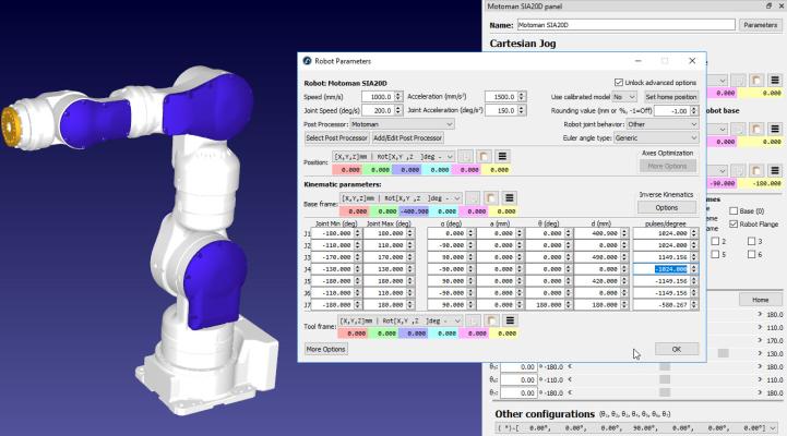

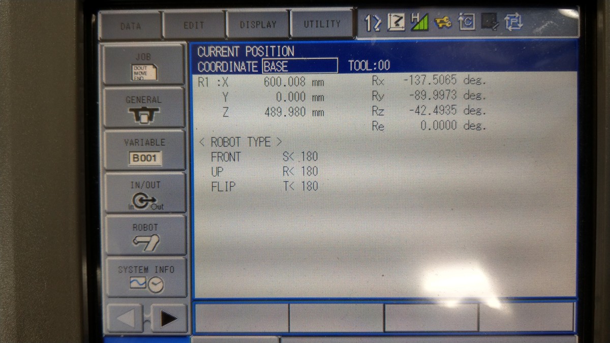

I generated a JBI which move robot to RoboDK defined home position, and then run the job on robot pendent.
Base on the position info of pendent, the robot moved to correct position without problem.
But if I use the "Get position" function to get the current position from robot controller, the position changed to as "Home_Robot" position as shows in the station project.

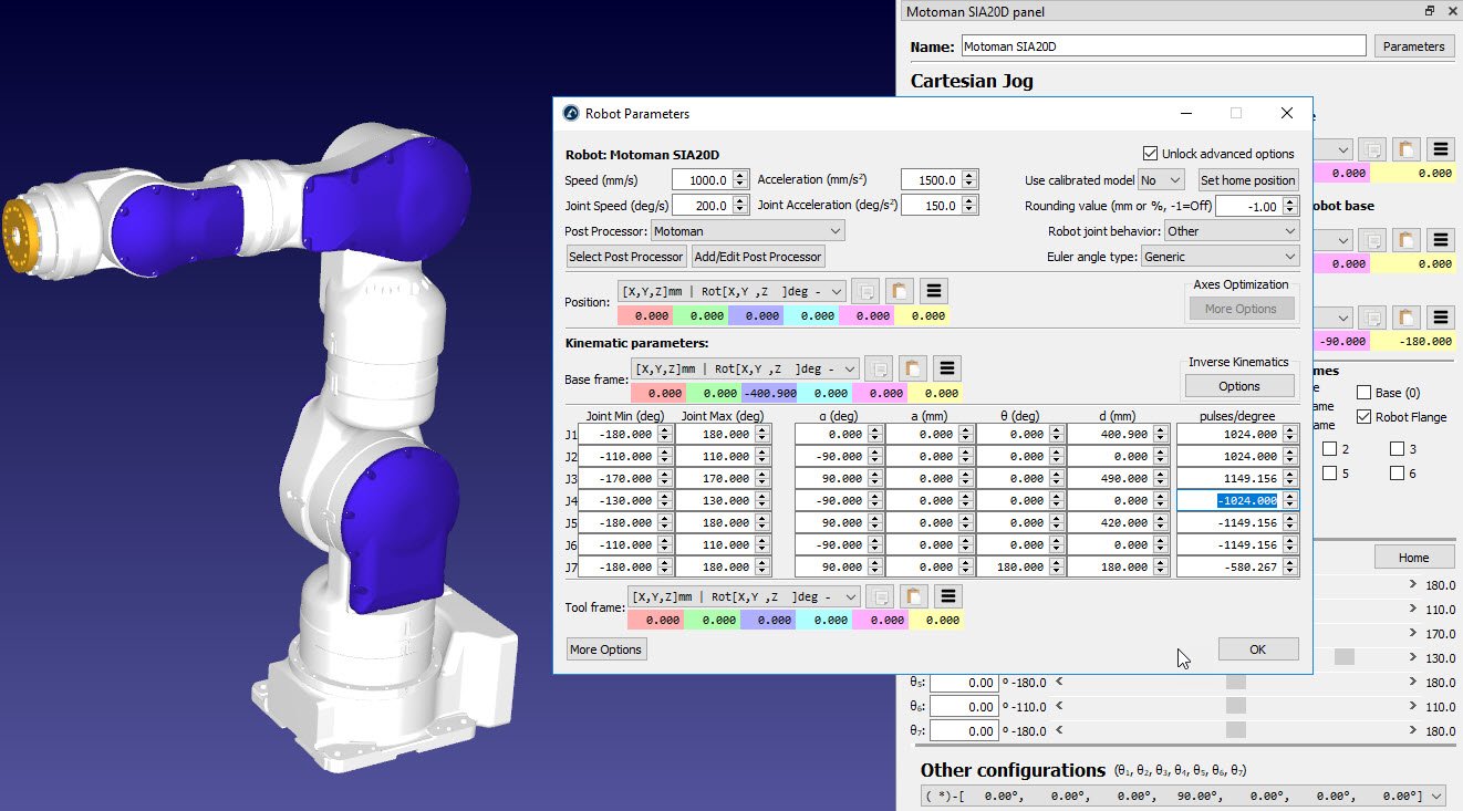

Hi Jeremy,
Base on the testing result, the pulse/degree settings of J4 of Motoman SIA20D should change from -1149.156 to -1024.
Best regards.
Pence
Hi Pence,
Thank you very much for your feedback. We just updated the pulses/degree for the Motoman SIA20D as you suggested and updated the robot in our library.
Let us know if you need more help.
