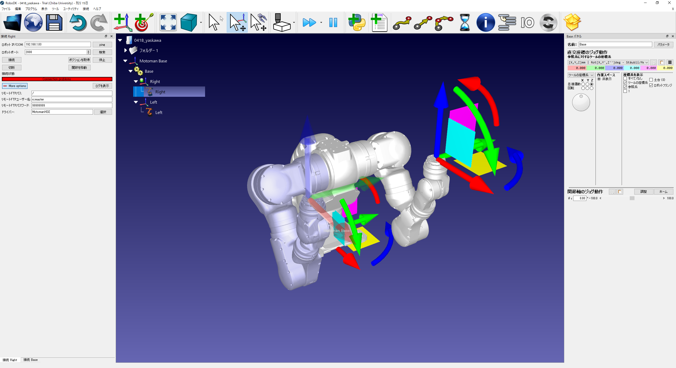

Hello RoboDK support,
This question is a continuation of the URL below.
https://robodk.com/forum/Thread-Connecti...oman-FS100
I adjusted pulse and created a model according to the answer you gave me, but it didn't work.
So I also contacted Yaskawa Corporation, and they responded that it might be because the Fast Ethernet feature option is missing.
What are the standard Fast Ethernet features used by MotomanHSE?
[*]use:MOTOMAN-SDA20D/20F
[*]Controller:FS100
I attached the error log and the simulation screen.
