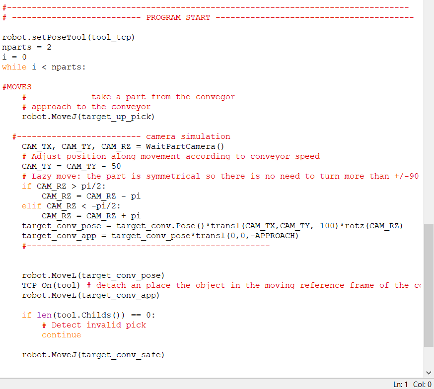

can help me understand why my robot is unable to reach the target, this error appears

This issue usually appears when the target is too far away and outside of the robot workspace.
Can you send the RDK file so we can take a better look? A similar question has been posted here: https://robodk.com/forum/Thread-Target-is-not-reachable Albert

I managed to solve my previous problem, thanks,
a doubt, why this command will erase my replace objects program and not just the created TCP Code: for tool in robot_tools:
