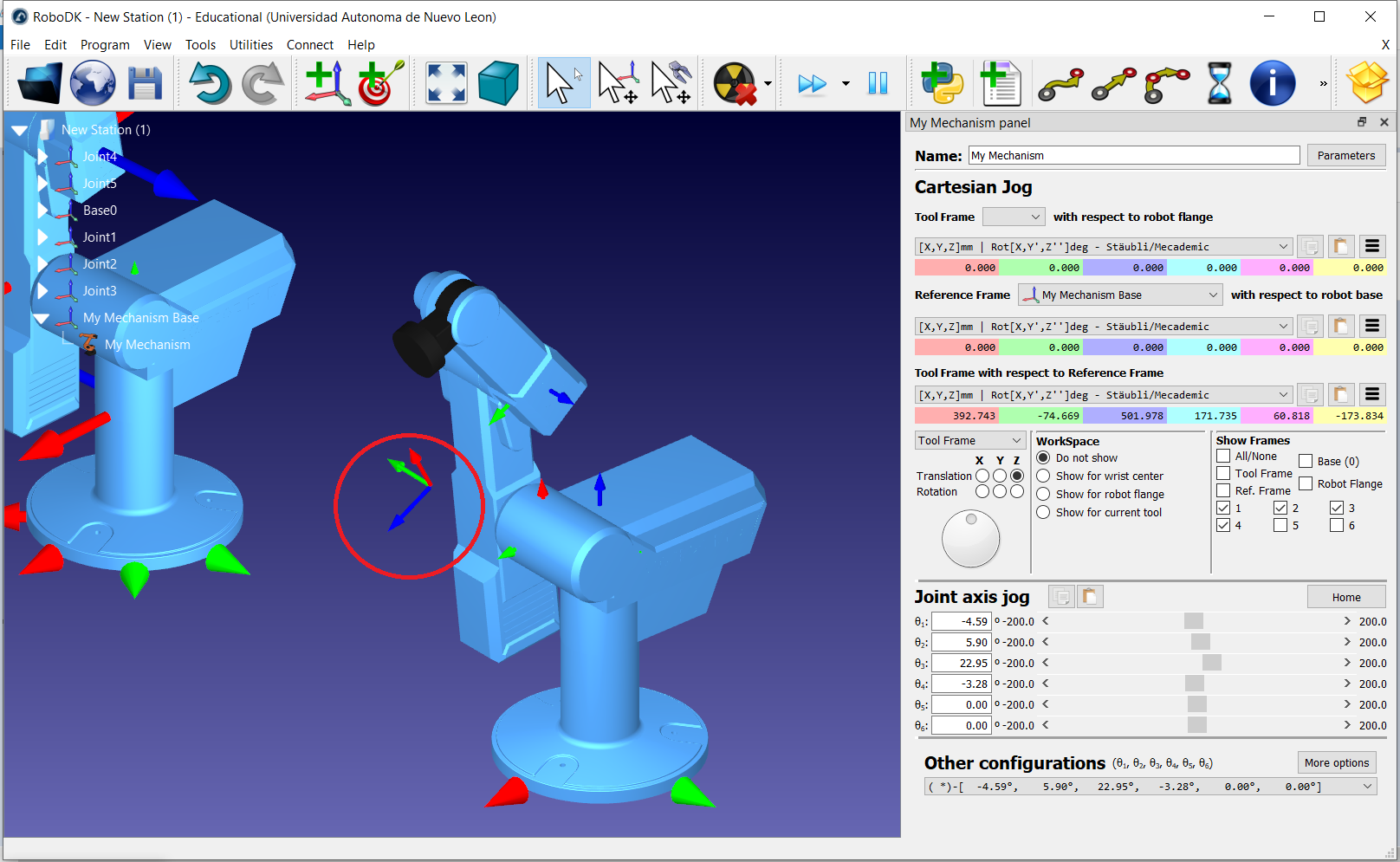

5 axis.png    Is it possible to create a robot with 5 axis?

Thanks Jeremy,
Please review the robot, move it with Alt + Left click it's not possible

Hi fmontemayor,
At the moment, it's totally normal. The way you built the robot, it's impossible for RoboDK to calculate the Inverse Kinematic of the robot.
I really don't understand what you did with your axes 4, but it's not cutting it mathematically speaking.

(03-18-2019, 05:15 PM)Jeremy Wrote: Did you try what I suggested you with the axes 5 and 6?
Yes.
I tried several configurations, but the problem is the orientation of axis 4
Can you help me build the robot, please?

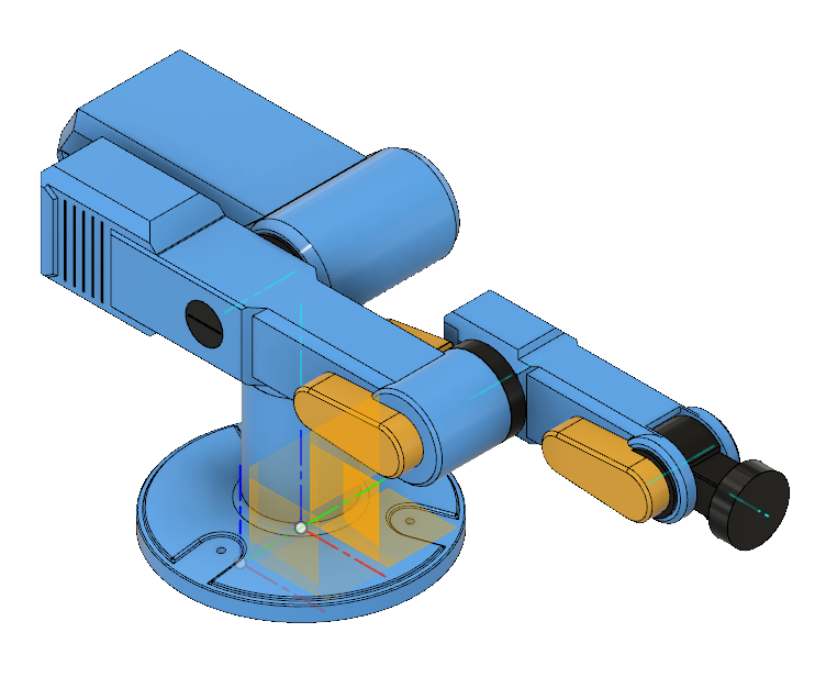

Hello
I added the files
Thanks
.zip   Scorbot ER-9.zip (Size: 2.05 MB / Downloads: 871)
