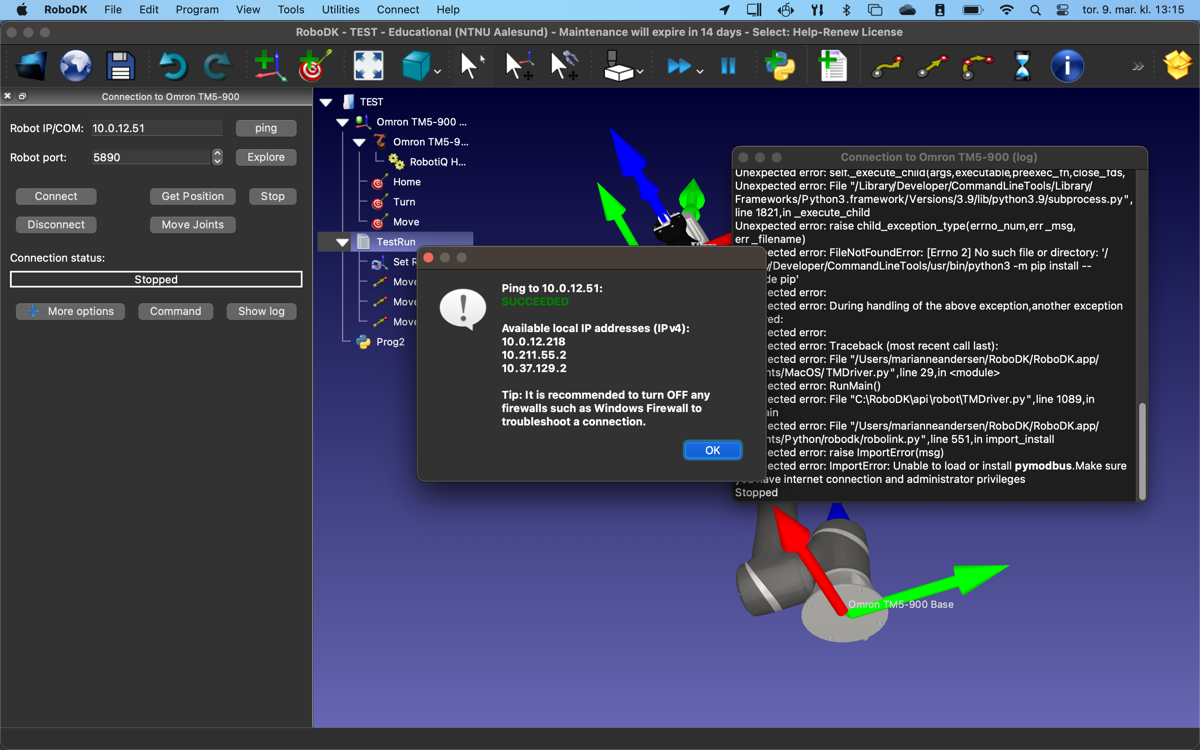

I can’t connect to my TM5-900. I have Mac M1 with Ventura 13.2.1. The ping is successful. I have the interpreter as python3 and editor as: "/Applications/Visual Studio Code.app/Contents/Resources/app/bin/code". RoboDK wants to load or install pyside2 and pymodbus but can’t due to lack of administrator privileges. I have already installed pyside2 and pymodbus and can’t understand why it wouldn’t work. I’ll attach the error message and screenshots. Hoping you can help me! Is it because of the command line tool?
.pdf   Error msg when connecting.pdf (Size: 40.26 KB / Downloads: 888)

Ok, I figured it out! I reinstalled conda, initalized and activated it. Fixed the paths.
I can now connect to the Techman. But if I try to run a program I get «ModuleNotFoundError: No module named 'pymodbus.client.sync'». The funny thing is that the robot still moves with the test-program I use, but the program stops. Pymodbus is installed and upgraded, but __feature__.py can’t find pymodbus.client.sync because it doesn’t exist on my computer. I upgraded the prompt_toolkit to no avail.
