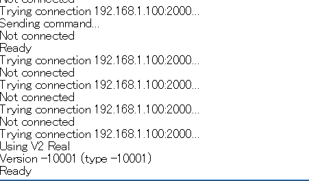

3.    Connect to robot:
3.1 Right click the mouse on the robot name of the tree, and select connect to robot
3.2 Input IP address just set (e.g. 192.168.1.10)
3.3 Default port 2000
3.4 If set correct, will get a green signal ‘ready’

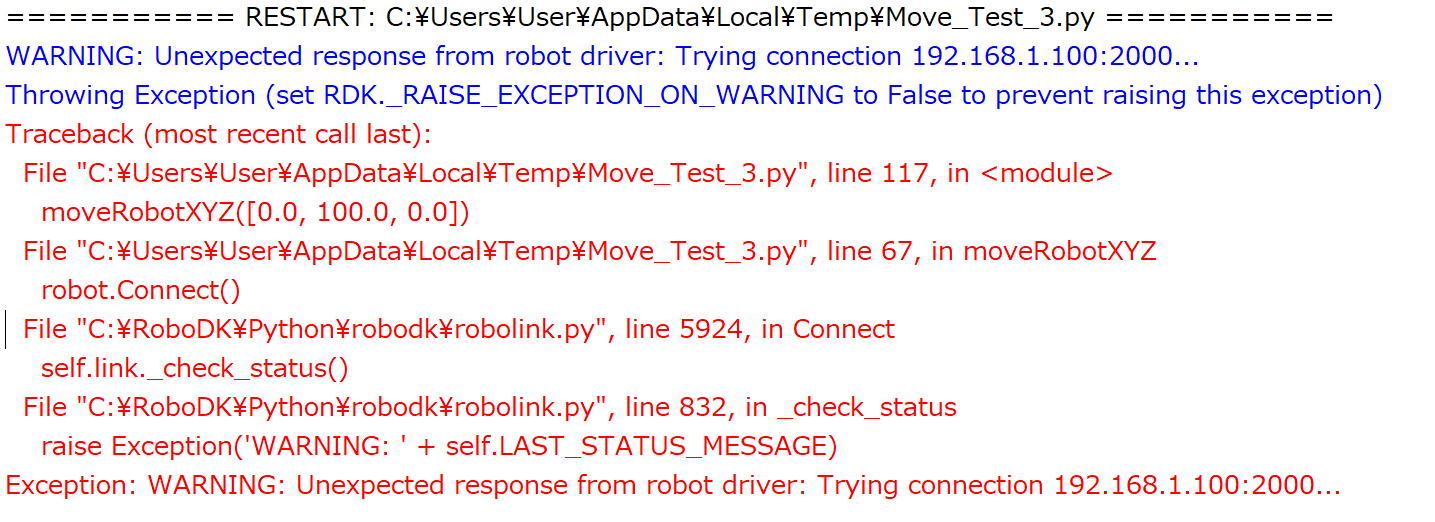

4.    Add python program:
4.1 program->add python program
4.2 right-click the ‘Prog1’->edit python script to start python programming, there are three methods to run python code:
-       F5 in editor: execute python code and a message window shows(only under this mode).  When the window is opened, run on robot dn’t work
-       Right click ‘Prog1’->run python script : simulate the python code and draw trajectories on RoboDK screen
-       Right click ‘Prog1’->run on robot: execute the python code to robot

I also use the Fanuc CRX and can connect it with RoboDK, but the connection is sometimes unstable. According to the logs, it repeatedly shows messages like "Sending command..." and "Not connected." After restarting RoboDK and the RDK_S3.PC application a few times, the connection is eventually established.
From the logs, I’ve noticed that once the message "Using V2 Real, Version-1001 (type -10001) Ready" appears, the connection tends to succeed. If there are any recommended solutions or troubleshooting steps to improve connection stability, I would greatly appreciate your advice.
Image(s)
Are you using the latest version of RoboDK and the driver?
If you see version -1001 this is not a good sign.
(08-26-2025, 11:29 AM)Albert Wrote: Are you using the latest version of RoboDK and the driver?
I am using RoboDK latest version 5.9.1.
and driver is might be latest version.
can you teach me how to check the driver's version or can I send the driver files to you?
Attached Files Image(s)
Can you send us a formal request through our contact form and mention my name and this forum thread? We can help you better:
https://robodk.com/contact
If you have a Professional license it is better if you contact us through Help-Request support.
