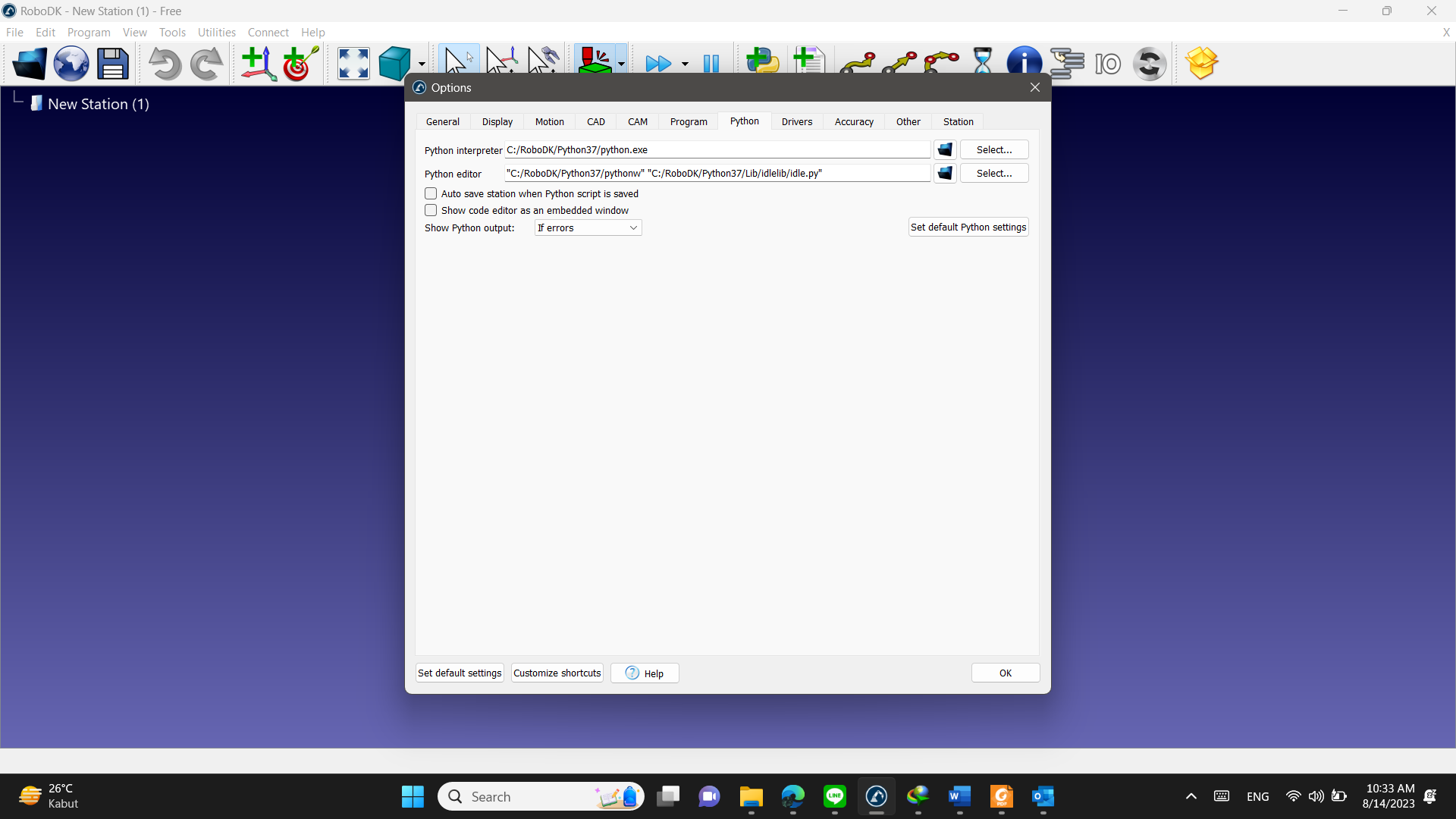

i already use python 3.7 if we reffer to this link
https://robodk.com/forum/Thread-Can-t-connect-to-robot
Did you set the switch to remote on the teach pendant?
This issue should be unrelated to Python settings.
