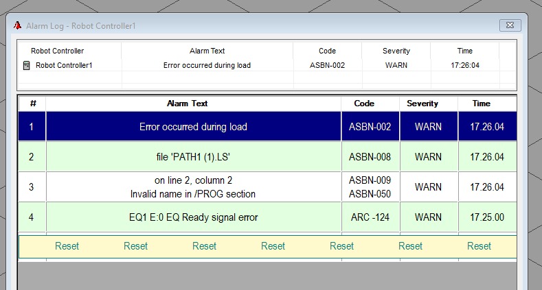

Attached a print screen of the error
.txt   SIMAR.txt (Size: 4.95 KB / Downloads: 303)
This Fanuc import issue could be related to the file name of your program file. Have you tried renaming the file to PATH1.LS instead of PATH1 (1).LS to load it to your controller?
