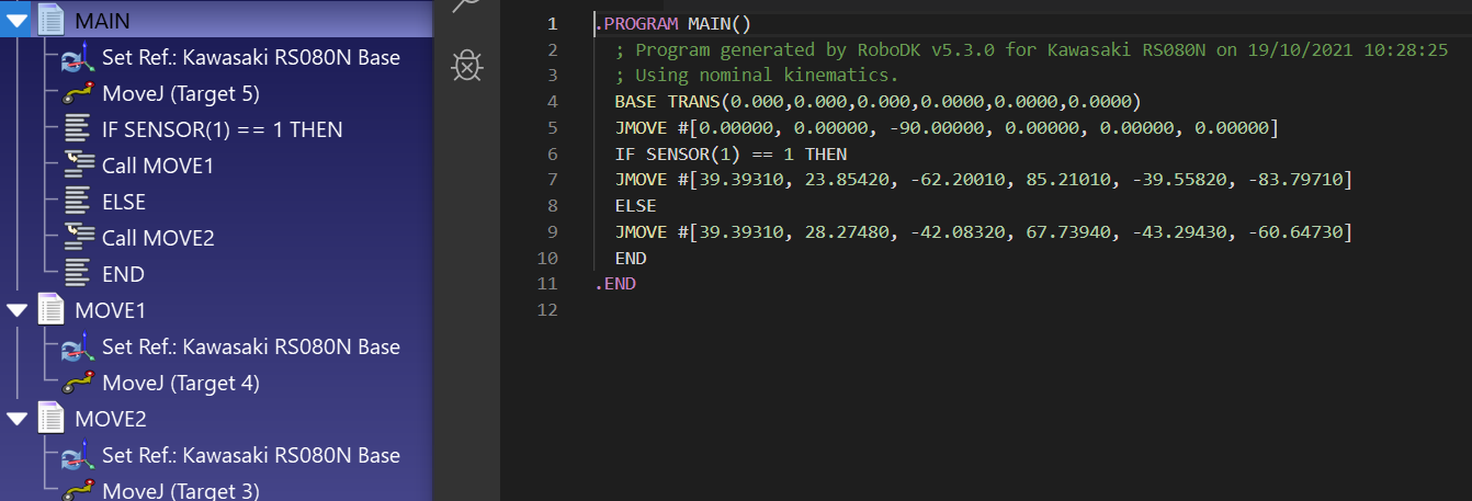

I was suggesting you split the logic as multiple program call and insert code instructions. See attached image image and RDK file. You can send us an email requesting the source code of the Kawasaki post processors and we can send them to you.
.rdk   If-then-inline-program-v2.rdk (Size: 1.47 MB / Downloads: 47,740)
