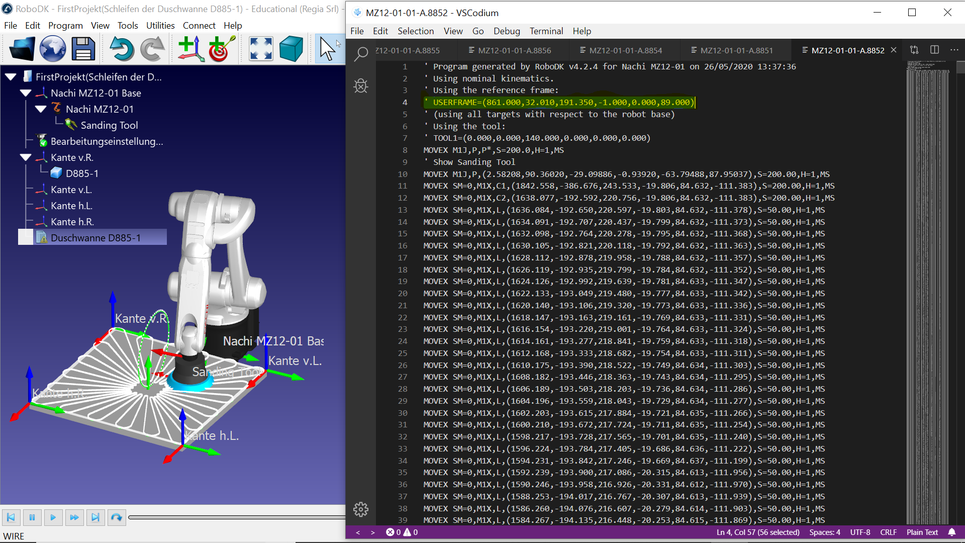

When I'm generating my programm for sanding with a Nachi MZ12-01 it gives my points shifted by the value of the userframe.
The userframe is added on every of my axis and I don't really know why...
The simulation is working fine...of course the program isn't usable on the robot cuz the points in the generate programm aren't reachable.
Thanks.

Tried it, but failed...
When I'm simulating everthing is fine.
The points in the generated program are out of reach but I don't know why it is happening like this.
a video says more than tousand words...
Hope you can help and show what is going wrong.
https://www.dropbox.com/s/uw99wlvw1iedrk...g.mp4?dl=0
