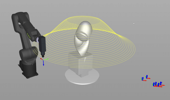

What you see at the end of your program where the turntable stops and the tool tries to continue to move following the path is a common issue that you reached the limit of the turntable. You can simply extend the limits by a factor of 100.
Also, you should place the part in a coordinate system held by your turntable and select it in your robot machining parameters.
You can also speed up the calculation if you set the parameter Allow a tool Z rotation of +/- 0 deg instead of 180. By doing this, your last machining operation (axis parallel) should be created in less than 10 seconds (as opposed to probably 2 minutes).
Another detail: I used the simplify mesh Add-in to reduce the size of the 3D model. It was way too detailed which was creating a heavy part to display and to save as a RDK file. I used the default settings and the mesh size was reduced by 80% approximately. You can find this Add-in here:
https://robodk.com/addin/com.robodk.app.simplifymesh
See attached image and project with these changes.

This is great and very helpful. On that topic, is there an unlimited setting that can be applied for unlimited turntables? I've maxed out the sliders in testing.
Lastly, can you cross check my ImportCSV KUKA scripts in the attached file? I edited to remove the original csv formatting. Im receiving a long circular spiral curve. If this is the long approach you were mentioning prior, I will circle back with my integrator on why this is in the csv.
