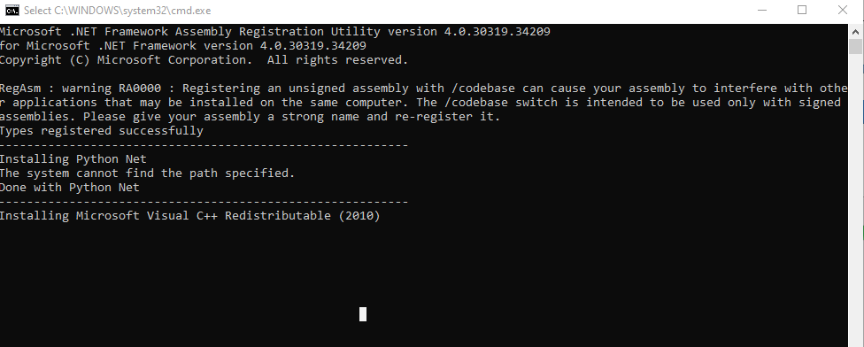

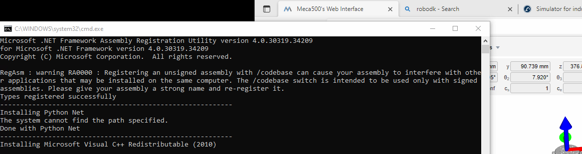

I did note some issues during install such as this:
That looks like something failed, but was not fully captured or traced.
