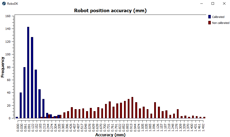

Achieving a high accuracy with bigger robots can be challenging. Industrial robot arms are highly repeatable but not accurate, the nominal accuracy of a robot depends on the robot brand and model. In your case, 3 mm seems a bit high but not enough to discard kinematic accuracy as the culprit.
Have you tried with different parts?
Is the 3mm error constant in a single direction or does it vary?
RoboDK Calibration can be used to calibrate the robots, a measurement system is required to calibrate a robot. You can read more about this in the following link:
https://robodk.com/doc/en/Robot-Calibrat...acker.html
You can see a sample report of our accuracy measurements/improvements here:
