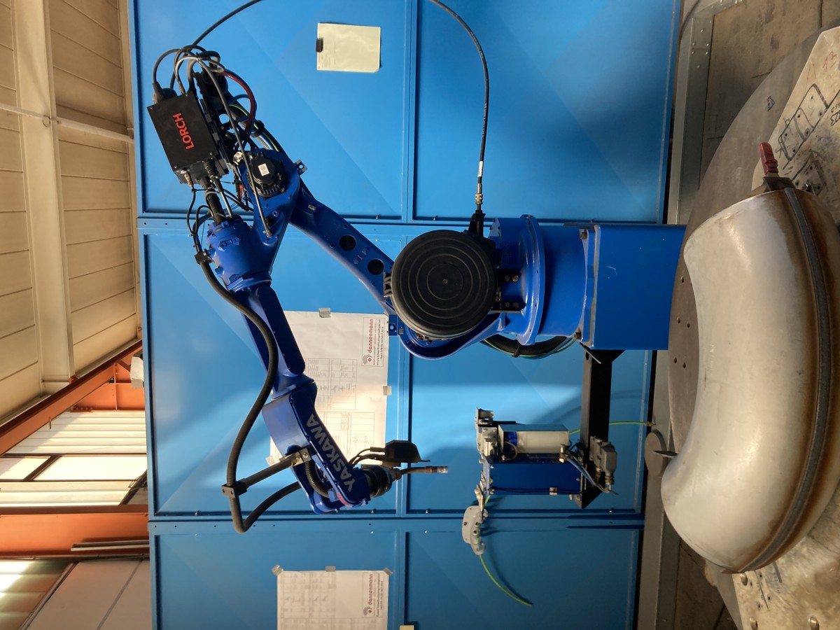

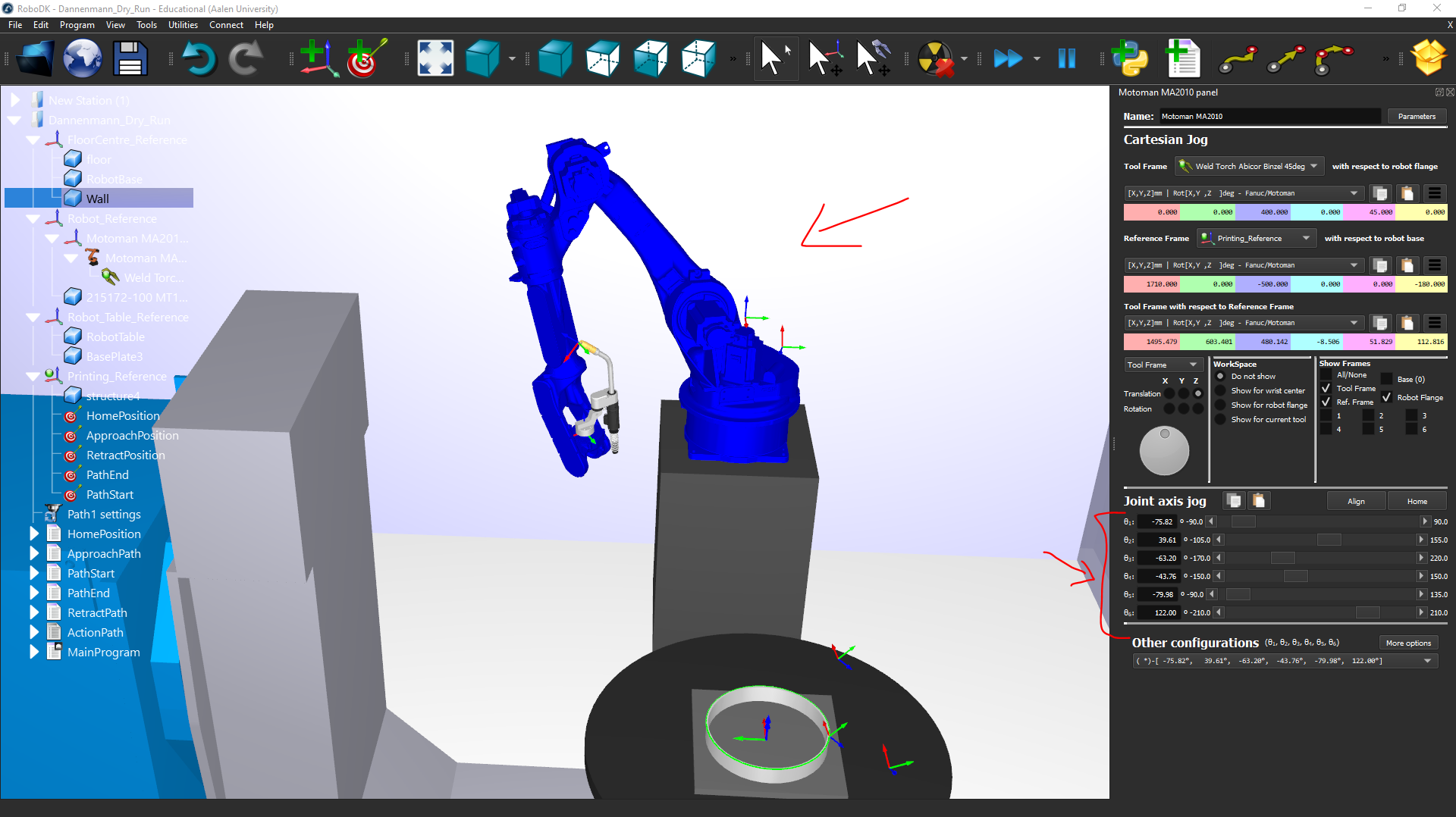

        I had calibrated the joint values of mine 6-axis robot and exported them to RoboDK, but in simulation the robot is crashing. The position of the robot is completely different compared to real robot. How can I correct the robot position in RoboDK?

Ok, there's something wrong here for sure.
Can you do something for me?
Bring the robot to its home position, take a picture of the robot, and a picture of the joint angles on the teach pendant.
Move the 3, 4, and 5 by something like 30 degrees, take a picture of the robot and a picture of the joint angles on the teach pendant.
We should be able to solve all of that pretty quickly.
Sorry, for the late response. I had to wait a couple of days to run the robot. Here in this mail you can the Link which contains the pics of the robot and its joint values(U,R,B)/ (3,4,5).

This issue is specific to Yaskawa Motoman robots.
You should make sure you properly enter the pulses/degree ratio in RoboDK. More information here:
https://robodk.com/doc/en/Robots-Motoman...omanPulses
