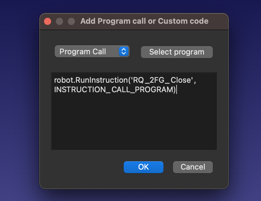

I tried the steps that are mentioned in the forums for controlling the gripper. I have used the steps as suggested by Albert (RoboDK Moderator). When I tried to run the program it displayed "No connection could be made because the target machine is actively refusing it"
I have also attached an image of the message and other details. Please let me know if I can do something to successfully control the gripper.

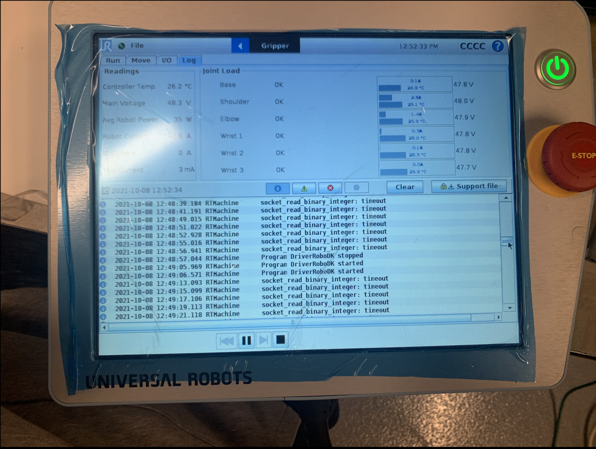

Did you attempt to connect to the UR robot from RoboDK before taking the left picture? The log in the UR teach pendant does not show any messages (normal or error message). Once you try to connect from RoboDK you should see some messages in the log. It will probably show the error messages.
(10-08-2021, 10:13 AM)Albert Wrote: Did you attempt to connect to the UR robot from RoboDK before taking the left picture? The log in the UR teach pendant does not show any messages (normal or error message). Once you try to connect from RoboDK you should see some messages in the log. It will probably show the error messages.
Hello Albert, Sorry I missed that part. I have attached the image with log information. Please let me know if this works. Thanks.

The print screen of the log window looks good. It does not show any problems. It means the robot is trying to connect to the computer. Did you try moving the gripper before taking the screenshot?
We wrote this procedure attached to connect to RobotiQ grippers. Let me know if it helps.

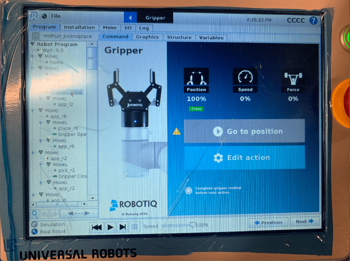

(10-19-2021, 08:45 AM)Albert Wrote: The print screen of the log window looks good. It does not show any problems. It means the robot is trying to connect to the computer. Did you try moving the gripper before taking the screenshot?
Hello @Albert,
Yes, I took the picture of the log after moving the gripper.

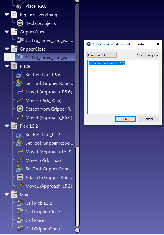

I followed the procedure as mentioned in the PDF. I extracted the file in the correct directory and followed all the steps, but still it didn't work. The manipulator arm moves fine but the gripper control has no effect on the real cobot.
Also, when I try Send program to Robot method nothing works even the manipulator arm doesn't work it only works by selecting "Run on Robot" directly. I have attached multiple photo and log data below for your reference. Please let me know if I can try anything else. Thank you.
