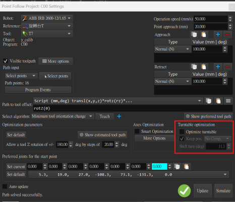

I used the python API to automatic generate the machining settings before without synchronized external axes. However, the panel of machining settings with synchronized external axes is more complicated. Is there any example to show how to control the panel? How to disable the "Optimize turntable"?

You can control the robot machining parameters using the API including the turntable optimization settings. Using the API is a bit more complex than using the User Interface but it allows you to automate and customize your workflow.
The 4 main settings you can control about the turntable optimization for a robot machining project are the following API machining settings you can use:
https://robodk.com/doc/en/PythonAPI/exam...g-settings You can also take a look at the following forum threads where similar topics have been discussed:

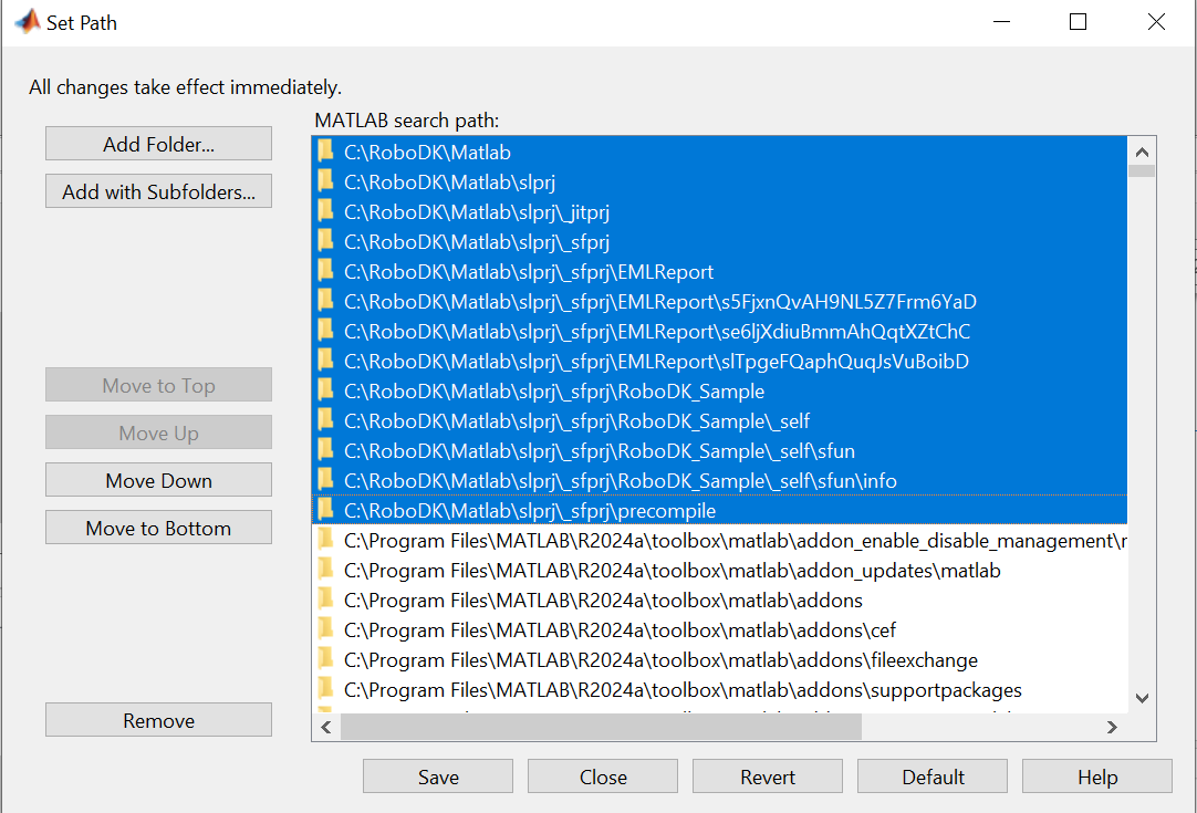

Thank you both for your replies, I have changed the data structure. However now I get this error message. The path for the RoboDK API of matlab is set appropiately (see the image below). Why is the setParam command not recognized?
Code: path_settings = RDK.AddMachiningProject('Path settings');Error: Unrecognized method, property, or field 'setParam' for class 'RobolinkItem'. Error in my_file (line 88) path_settings.setParam("Machining", machiningsettings);

Are you using the latest version of the Matlab API? You should find the latest version of the Matlab API here:
https://github.com/RoboDK/RoboDK-API/tree/master/Matlab The latest version includes the function setParam function.

Thank you very much for your reply Albert!
I updated the version of my Matlab API as well as the path on Matlab and I can change now the machining parameters!
