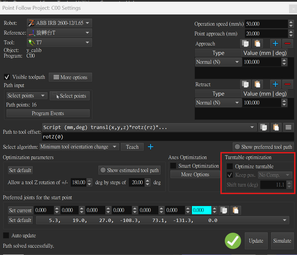

I used the python API to automatic generate the machining settings before without synchronized external axes. However, the panel of machining settings with synchronized external axes is more complicated. Is there any example to show how to control the panel? How to disable the "Optimize turntable"?

The 4 main settings you can control about the turntable optimization for a robot machining project are the following API machining settings you can use:
  • TurntableActive (set to 1 to activate it)
  • TurntableOffset (offset of 0 deg is the same as 0)
  • TurntableRZcomp (set to 1 to have the default automatic compensation)
  • TurntableKeepPos (set to 1 to prioritize the position of the TCP instead of the orientation of the Z vector)
