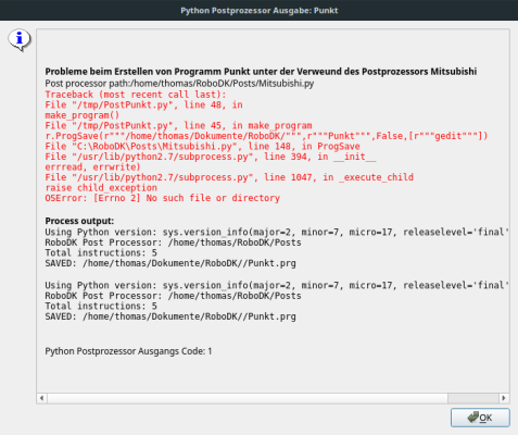

Another problem is that I cannot create the program because the Niryo One is not in the list of post processors. If I now choose any other processor (Mitsubishi in this example) I get the following error (see attached screenshot).

The error generating a program is related to your text editor not being properly selected. I recommend you to set your editor here:
  1. Tools-Options-Program
  2. Select Set here: Show program in text editor

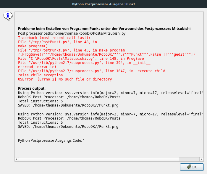

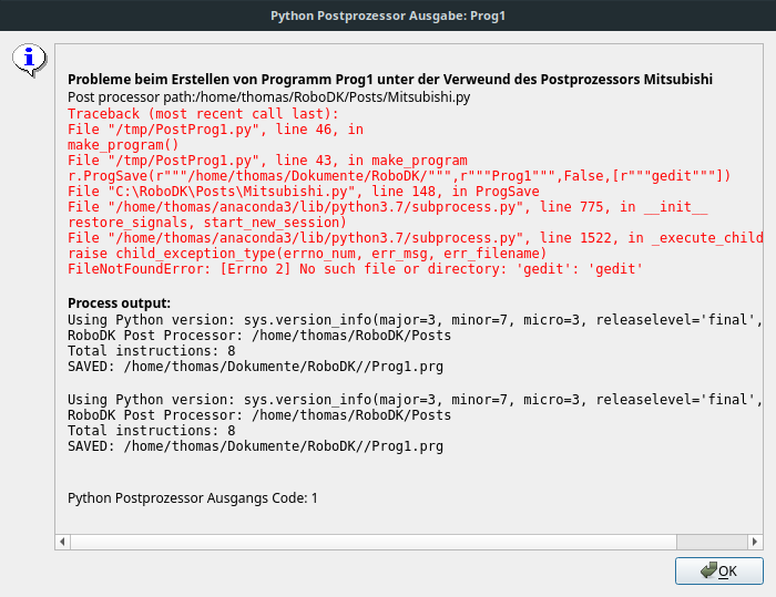

thank you for your help.  I found the text editor option and set it to the correct path. This works. I have found a generated file inside my tmp folder (see attached file PostPunkt.py) Unfortunately I get another error. (see attached file error_2.png)

Hello Albert,
after i installed and selected idle i could use the post processor. It seems that the change in RoboDk's interface regarding the text editor is somehow stuck.
