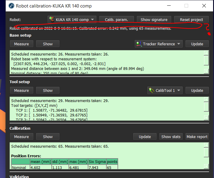

See link: Robot Calibration (Laser Tracker) - RoboDK Documentation
This is exactly what I need at the moment, a program to send my arm to the proper home position so I can unmaster and remaster it. Did this move somewhere or did we lose it entirely?
I'm using a machinist's caliper otherwise, and it is not enough. A 4-point TCP through the pendant has a mean error of 3mm.
