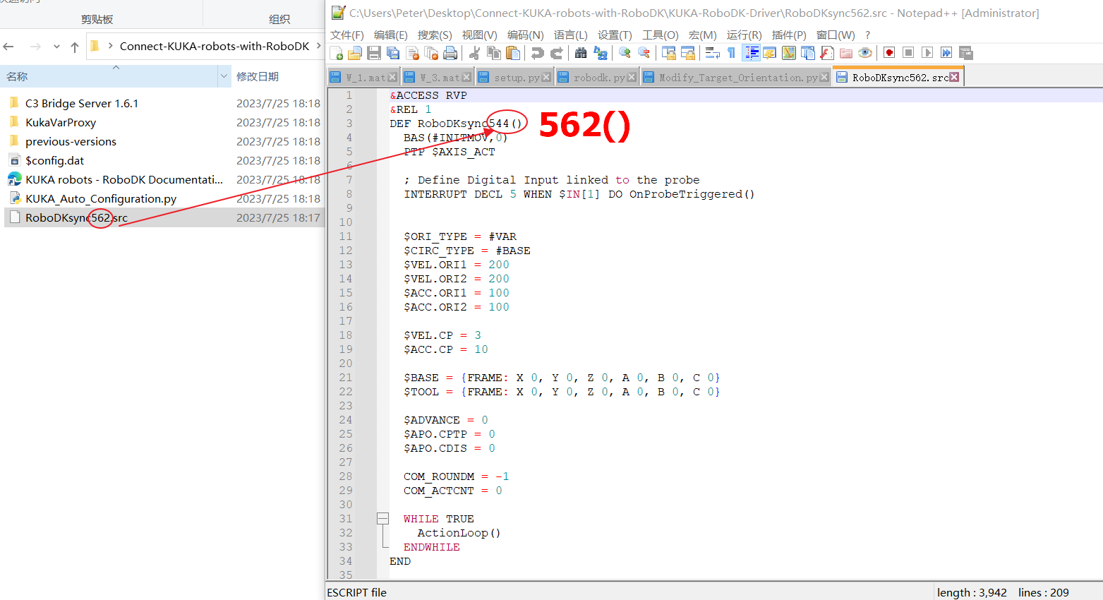

Maybe there is a way out.  Manually Changing the name of def function  to be exactlly same as the SRC file name. Of course ,you should define certain global variables in $ config.dat first.
Thank you for your feedback Peter! We'll fix the official version of our driver script.
